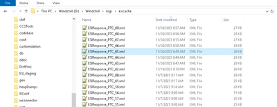

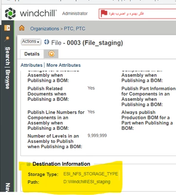

It looks like I have successfully output the file thanks to you, but I don't know where it was output to.
I thought the "path" of the attribute item of the distribution target was the output destination, but after linking the distribution target and the part I created, I couldn't find the file when I tried to "send distribution target".

share a screenshot of your DT ,destination information:

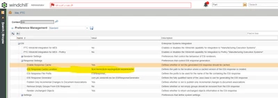

anyways we have a preference
  • ESI Response Cache Location = $(wt.home)$(dir.sep)logs$(dir.sep)esicacheFadel_0-1700546916508.png
A copy of the XML file should be stored under <Windchill home>/logs/esicache
