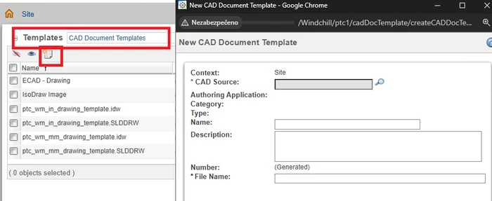

    Hi @AK_13732694
    Check in the drawing to the windchill
    then go to the Template administration on a Site
    Create a new CAD Document Template
    search for your drawing template file in the Windchill
    Done
    After that you can create a drawing from a workspace
    PetrH
    Sep 5, 2025 9:29 AM UTC
    Hi HelesicPetr,
    This is the general process to create a CAD template in the Windchill. But for NX the CAD extension is .prt so it is not recoginize it as a NX 2D CAD Drawing template. it is taking it only has a .prt (3D CAD Part). Coz of that i cant able to create a 2D CAD Template.
    HelesicPetr
    Sep 5, 2025 9:32 AM UTC
    I do not understand.
    Just use the file , and then you can use it as a template.
    Were is your trouble? Wrong icon? it does not matter. Use a drawing template as a name.
    In my opinion does not matter if it use the .prt extension
