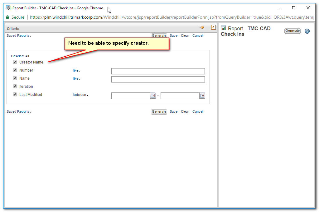

I am stuck.   I had an engineering manager ask me for a report of the objects his reports have checked in over the last few months, and I am not sure how to proceed.   Anyone have any ideas to get this thing rolling?
Mostly EPMDocs and WTParts for the objects.   He wasn't interested in WTDocuments.
I created a search easily enough, but getting that translated into a report has me stumped.
-marc
1st Attempt at the Report:
Results in this:

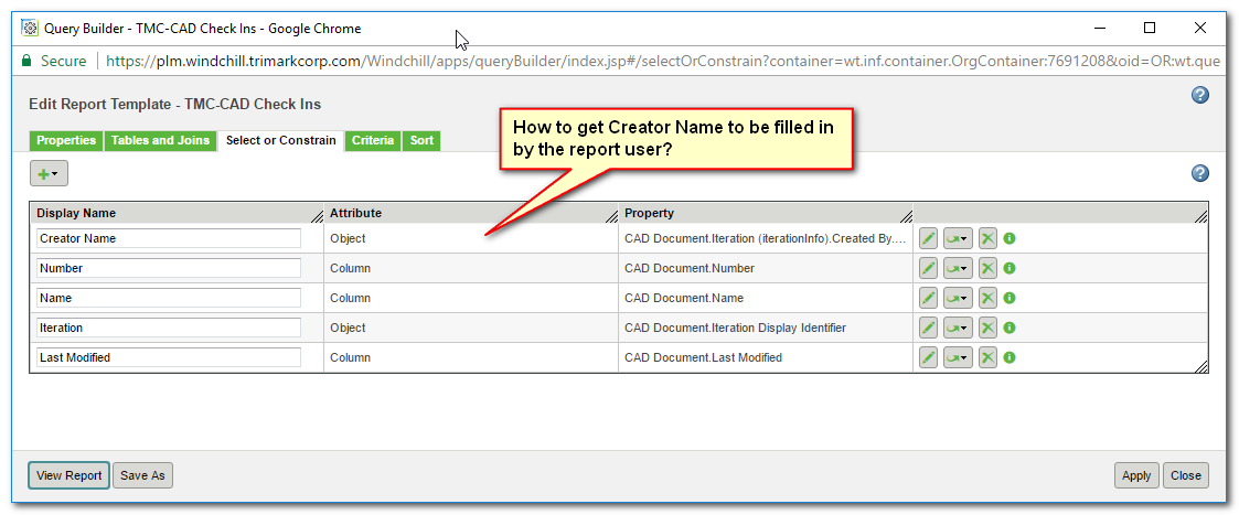

Hi Marc,
It's because you are using the creator from the epmdocument which is a derived column. You can add "user table" in the select and add a creator link between user table and epmdocument. That will allow you to filter by user name.
Regards

Thanks Binesh!
That was the trick.   I don't create reports all the time, so I have to relearn all these lessons each time.   But nevertheless, I successfully created the exact report I needed with your help.
