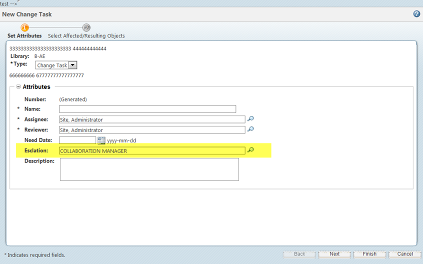

You can create attribute of string type and create data utility to replace textbox with User picker. Below are the steps
  1. Write data utility by extending the com.ptc.core.components.factory.dataUtilities.DefaultPickerDataUtilityand override the setModelData method to specify the pickerConfig, following is an example
public void buildUserPickerConfig(final String component_id, final ModelContext mc) throws WTException {
           HashMap<String, Object> defaultProps = new HashMap<String, Object>();
           defaultProps.put("objectType", "wt.org.WTPrincipal");
           defaultProps.put("pickedAttributes", "name");
           defaultProps.put("readOnlyPickerTextBox", "false");
           defaultProps.put("showSuggestion", "true");
           defaultProps.put("suggestServiceKey", "OrgPicker");
           HashMap<String, Object> customProps = new HashMap<String, Object>();
           if ("Esclation".equals(component_id) ||"OrgAttribute".equals(component_id)) {
                 customProps.put("pickerId", component_id);
                 customProps.put("pickerCallback", "CustomPickerInputComponentCallback");
           defaultProps.putAll(customProps);
           mc.getDescriptor().setProperties(defaultProps);
          2. Use attribute internal ID from the Type manager for the new IBA created and register the data utility in the service.properties file refer customizer guide for registering data utility
hope it helps !!
