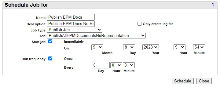

A quick way to do this is by container using Utilities, WVS Job Scheduler Administration

Aaronm8714-AlexandriteAuthor
Sep 8, 2023 5:53 PM UTC
Exactly what was I looking for. Thanks it works perfectly!
