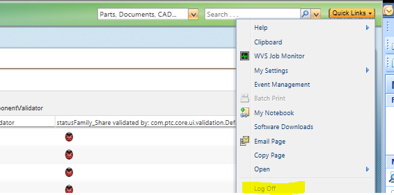

You have it already in WC 10.2, but by default it is disabled, you need to enable it to be visible.
Aug 31, 2016 2:36 PM UTC
Mohan,
How do you enable this?
Aug 31, 2016 6:00 PM UTC
It looks like log off capability is available for form-based authentication and is not available with the default basic authentication.
Anyway to enable the log off -
"xconfmanager -s wt.auth.form.enabled=true -t wt.properties -p"
"xconfmanager -s wt.logout.url=https://ptc.com-t wt.properties -p"
