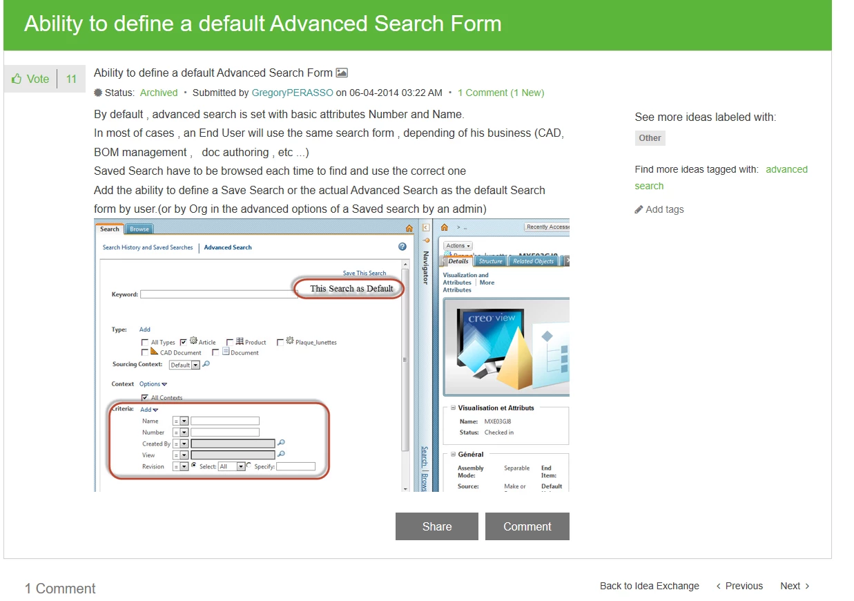

By default , "advanced search" is set with basic attributes Number and Name.
I would like to add few other attributes by default.
How can we do that?
I try to find a way to do it since a while, without to have to use "save search".
I find this this old topic (see picture attached) but no answer to this issue.
Thanks a lot in advance!
