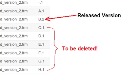

How to delete all the iterations of drawing format that are not released?
Hi there, the above is the screenshot about the issue: the released version of the drawing format is B released in 12 months ago. Since then, the drawing format has been accidentally revised to Rev H. We need to delete the drawing formats of revision C, D, E, F, G, and H. however, Windchill doesn't allow it, saying they are used in other workspaces.
How to delete them and only keep the released version B?
Thanks.

The Windchill admin can delete them working backwards from revision H and can force a removal from a workspace. The catch will be that IF these formats have been used in a drawing template or a drawing, then that may limit your ability to delete them.
Formats should be in your standard configuration library and ONLY the Librarian (or Admin) can revise these files.

Use Purge for this in general.
Delete is from the latest back in time.
Purge is for non-latest.

Purge can only be done by Site Admin. It's under Site / Utilities, Purge.
It's relatively complex - have to create a query with criteria and then run it.
For this particular case, a good approach would be to create a new Library, then move the Format to that Library, then run Purge on only that Library context, then move the Format back where it was. This eliminates most of the complexity for the query, etc., and ensures that nothing else will be purged.
An alternate as suggested by other user would be to preserve the latest and then Delete, then add the latest back as the new Rev, and that might be just fine also.

@TomU  has it right. A drawing references the master of the format NOT an iteration of a format. Therefore you should be able to delete from H.1 backwards until B.2 is the latest, unless the iterations to be deleted play the B role in any links. If that the case those links must be deleted first.
If they are in workspaces such a link exists and it needs to be deleted.
Are you getting the OOTB Remove from workspace option when you try to delete? I guess you are but drawings that’s reference the format are in the workspace too.
If a format is on an ECR the link to the ECR must be deleted before the format can be deletedas well.

If it were me I'd remove H from the ECR using the GUI
I'd remove C thru H from all workspaces. This will mean removing the drawing as well.
Then I'd delete H thru C.
Removing from WS could be a PITA using the GUI if you have a lot of Workspaces involved.
Who knows how many workspaces C thru H are in?
A Query Report can be written to find this info.
Or a utility can be written to be run in a Windchill shell.
In this case the utility would work by entering CAD Doc's number (maybe the rev too to get more granular)
The utility would then print the:
  • number rev.iteration
  • WS name
  • the user who owns the workspace.
After you know the Workspaces you could run the same utility with a -remove argument which would remove the object(s) from WS.
From there you can delete the H thru C using the GUI.
