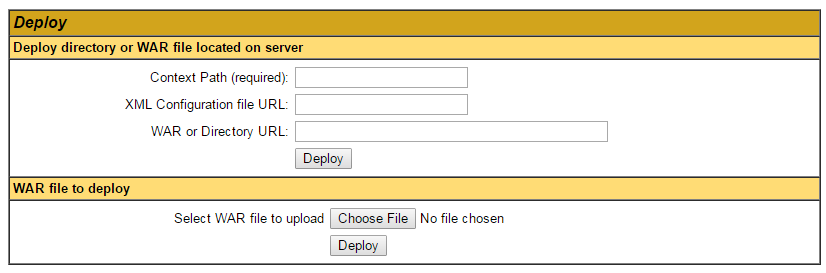

Hello Everyone,
I have test.war file, wanted to be deploy in windchill. how i can achieve this ??
I puted my test.war file in tomcat\webapps folder and restart the windchill but not working.

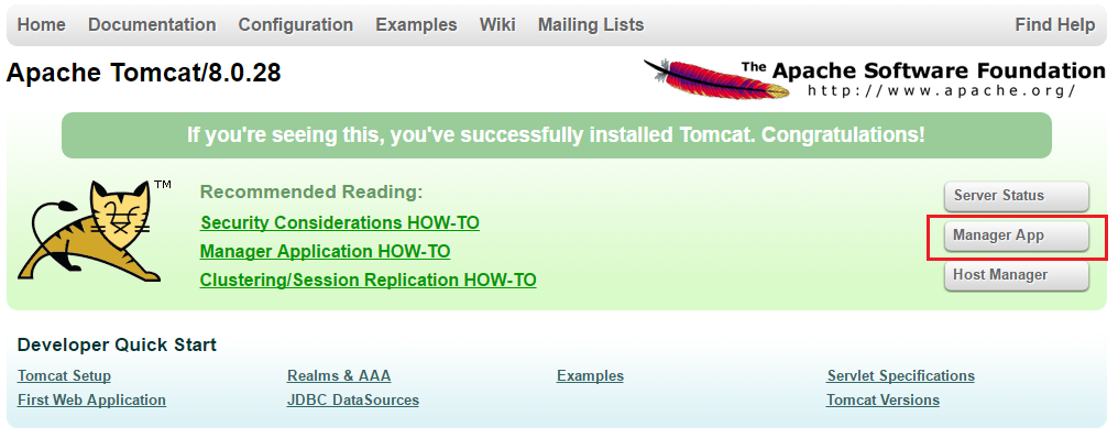

I'm not sure about the Tomcat bundled with Windchill, but if you have Tomcat installed standalone (like for ThingWorx), the Tomcat "Manager App" is used to deploy .war files.

With the below steps you should be able to deploy a war
  1. Copy the war to a directory say - /app01/windchill11/Windchill/tomcat/webapps/sample
  2. Open a Windchill shell run the command , navigate to /app01/windchill11/Windchill/tomcat and run the below command, appName is the what you use after server name to access the application. This will install the web app on Windchill Tomcat
         ant -f config.xml  installWebApp-DappName=sample-DdocBase=/app01/windchill11/Windchill/tomcat/webapps/sample
  3.  Now you have two options either to enable direct HTTP access on tomcat to access the app or use web server directives direct the traffic to tomcat. if you want to enable
       direct access add  below line to /app01/windchill11/Windchill/tomcat/conf/server.xml.default
    <Connector port="8080" protocol="HTTP/1.1"
               connectionTimeout="20000"
               redirectPort="8443" />
Now restart Windchill and access the page - http://localhost:8080/sample.
