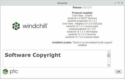

About Windchill displays this:
About WindchillAbout Windchill

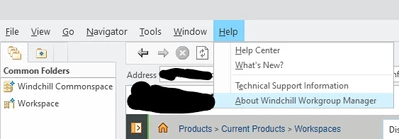

Here's how you can get the 'About' window:

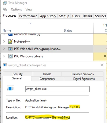

As for the installation folder - you can open Task Manager and look at properties of WWGM process:

My task manager does not list PTC Windchill Workgroup Manager.
uwgm_client.exe is not in the default location as shown in your screenshot.
Attempting to search for uwgm_client.exe, so far no luck.
