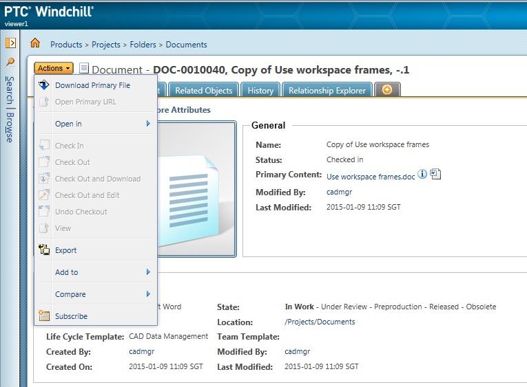

Hi everyone,
Can download function in documents can be disable even if you are in "viewer" group? Because most of our customer has a confidential document that they dont want to be downloaded, or print.
How to Disable Download Primary File menu?
thanks!,

Hi Luar,
Write a validator for the ACTION and disable the menu from all the place of windchill.
Br
MKR

Jan 13, 2015 12:50 PM UTC
Hi Luar,
Hava a look on UI Validation @customization guide. Lot of OOTB Java validator class is responsible for hiding/enabling/disabling an action. Explore it.

Jan 10, 2015 12:32 AM UTC
Do you want to deny everyone but the owner the ability to download?
If so, you deny Download permission on WTDocuments to all principals except owner?
Or you can deny Download to a group/user/role.
If the logic of determining who should have download permission and who should not is more complicated then you will need to create a custom validator per MKR's suggestion.

Jan 13, 2015 5:44 AM UTC
I think you can create an ACL where you can deny download permissions to whatever users you wish. ACL's are created via Site-->Utilities --> Policy Administration.
