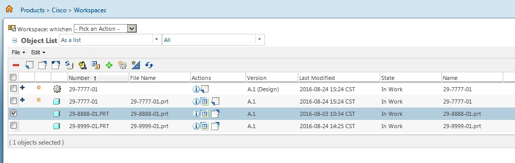

Can I ask one more question? I want get the part information in my workplace, when I select the part(show in picture), how can I get the part information by click customized button? I know I maybe need to use "NmCommandBean " and its method ".getSelectedOidForPopup()", but I don't how to use it, can you show me an example to use NmcommandBean class?

20-Turquoise
Sep 7, 2016 1:22 PM UTC
White Chen wrote:
Thanks a lot for your inspiring. My problem is resolved.
Check out the following thread:
Re: How to get Object details from selected row via custom action on separate jsp page
