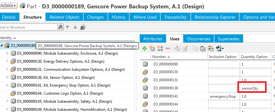

It's possible by speciying qty parameter in BOM structure on Uses:
Jun 2, 2016 3:31 PM UTC
Do you know if this is possible in 10.2 M030, if yes can you provide steps to reproduce the parameter in Quantity?
Jun 2, 2016 3:48 PM UTC
I haven't tried on 10.2 (11.0 is what I tried) but if you can load the sample Options and Variant loader it shall be self explained, just make sure to set PSE preference and open the config module in PSE
