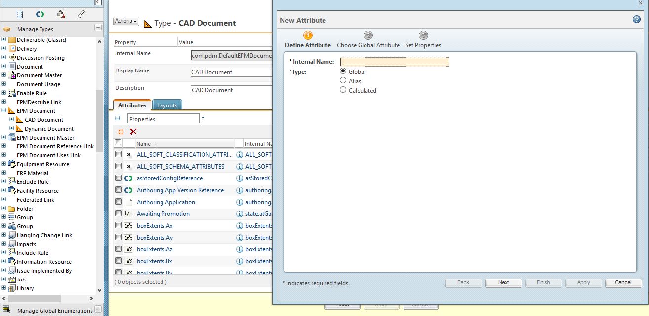

Thanks for your reply.
I dont find the option for adding data type(integer) inside epm doc.
Mar 4, 2015 5:18 PM UTC
I first created the global attributes - where it is obvious where to set it as Integer.
You then just reference it here. There is a section in the Windchill User Guide on how to create attributes. Clicking the question mark on that screen shot will probably take you to the right place.
