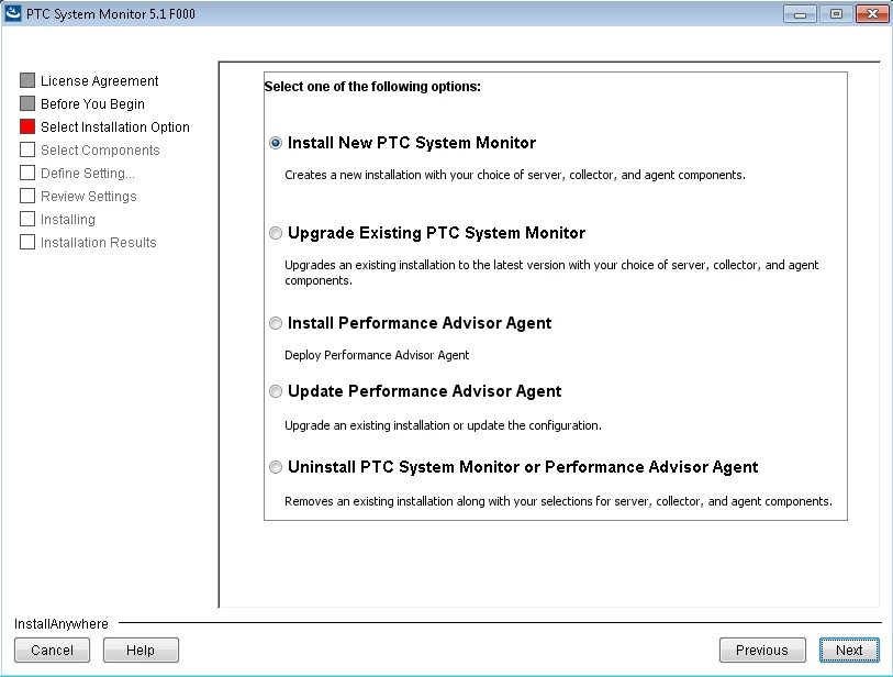

  1. Download PTC System Monitor Release 5.1 from the PTC Software Downloads > Windchill PDMLink > Release 11.0 > PTC System Monitor 5.1
  2. Run the PTC System Monitor Installer by executing PSMInstaller.jar
    1. Open command prompt as an administrator
    2. Change directory to PSMInstaller
    3. Run command > java -jar PSMInstaller.jar
  3. If you already have PSM 5.0 (or later) Installed, choose the Install Performance Advisor Agent option
    1. Otherwise, choose Install New PTC System Monitor, you can install and configure performance advisor agent along with PTC System Monitor

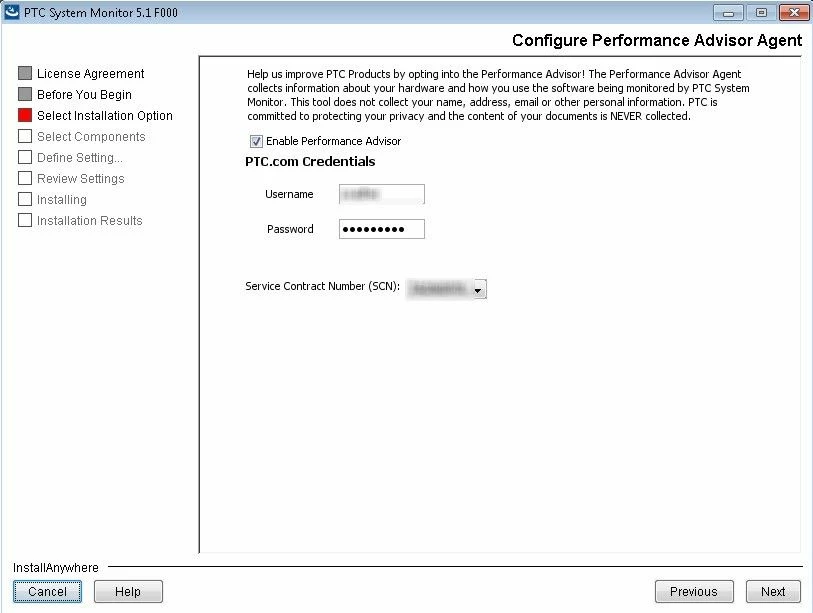

    2. 1.pngIn next step, Check Enable Performance Advisor and add PTC.com credentials. Click Next. 2.jpg

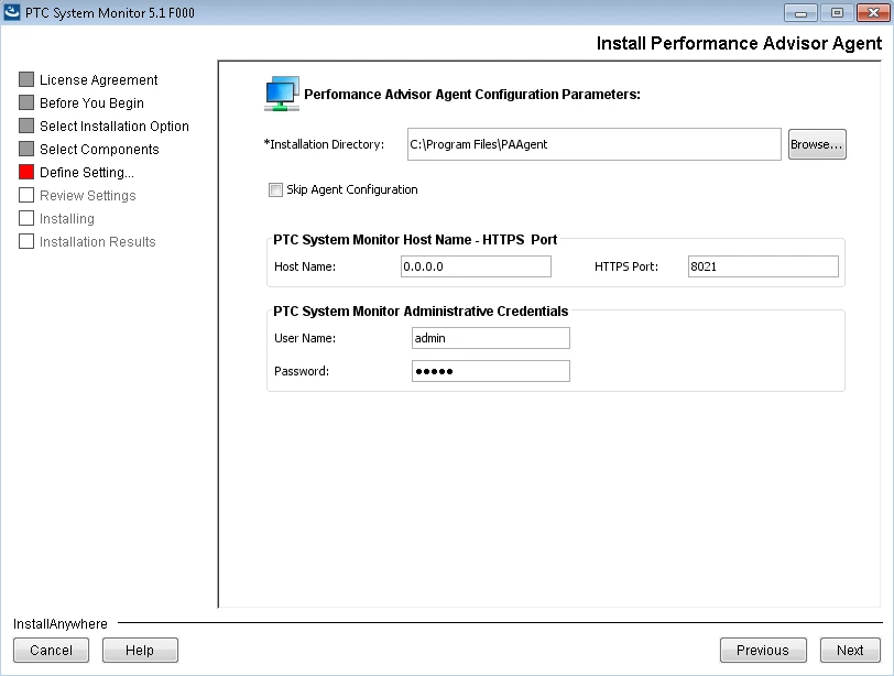

    3. Select PA Agent installation directory, add PSM host and Administrative user credential. Click Next.3.png

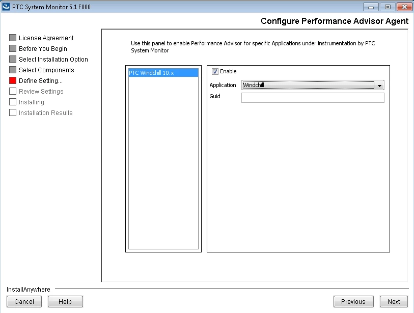

    4. Select the list of PSM System Profiles for which you want to opt-in for Performance Advisor and specify the respective server’s GUID. In order to find GUID for Windchill environment, connect to sql with dbuser credentials and run following command. SQL> select guid, displayname from repository;4.png
