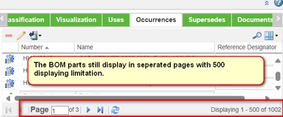

    Oct 16, 2024 12:15 AM UTC
    Hi ,
    Do you mean this setting? i have set the size limit to 2000.
    But the BOM parts in occurrence mode still display with 500 limitation.
