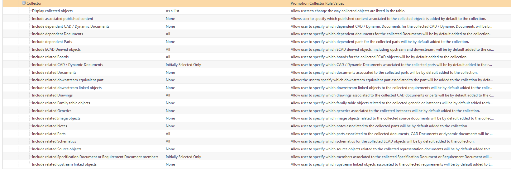

Windchill 11.0 M010-cps02 - We do not get the Drawing Format with the following promotion request collector preferences:

Thanks Randy.  We have the same preference settings - and don't get the Format on initial creation, but do on collection.  Same result here when checking "Apply default Collection" on first wizard page, or using "Collect" on the second one.  The Format I believe is considered one of the Required objects. I'm hoping there is something I'm missing on this though.
