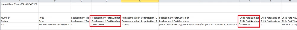

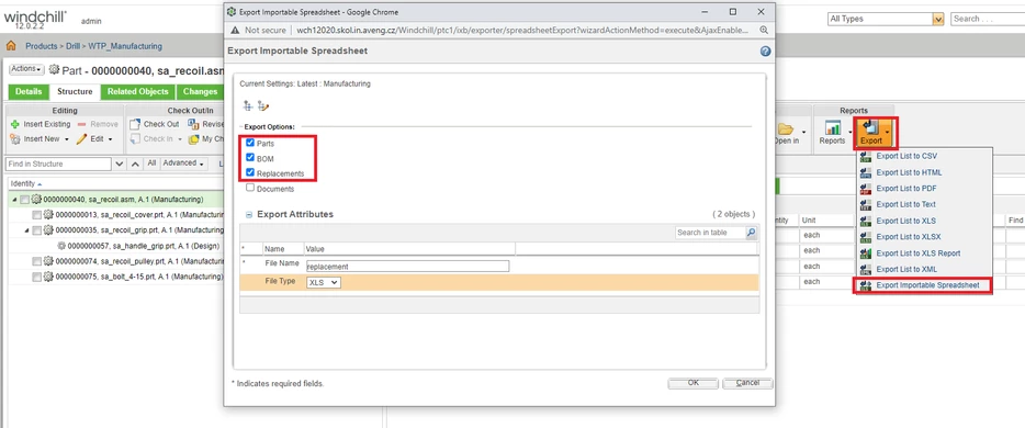

HelesicPetr
Aug 25, 2022 11:28 AM UTC
Hi @NSS
Have you try an export to importable spreadsheet?
You can chose to export the replacements and it is in separated sheet.
It is not so nice but maybe it is better then the BOM export with replacement.
Also keep in mind that a unit is same for replacement part as the original part. So the unit is same.
