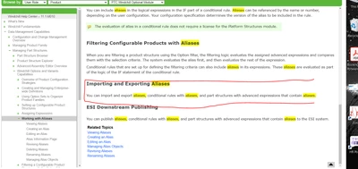

I've created lots of aliases for Options and Variants configuration. Supposedly those can be exported/imported but I can't find any way to do so. I can export the Options and Choices list, however there's no similar option available for Aliases.
See the SS from help center, which doesn't explain it in any way.

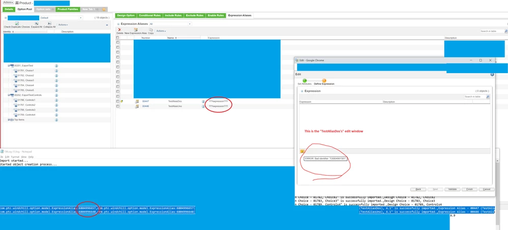

4. In version 11.1 M020 CPS 16 this function is completely broken, at least OOTB (currently working with support). Export and import logs are clean, everything supposedly works fine during execution. However, every Alias and every Assigned Expression which uses any Alias is broken (assigned expressions can be repaired, Aliases can only be deleted!) Their identifiers are wrong and inconsistent with the logs.
