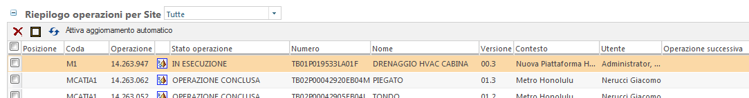

We need a report of the current pubblications. The best option would be an export of the Job Monitor table:
As the export in a file is not a provided function, waiting this function will be added, I ask if someone can help me to write a query that join the QUEUEENTRY table to obtain the same info of the Job Monitor.
I haven't idea on the other table and which are the keys to join tables.

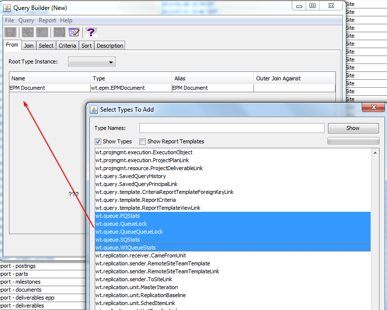

I start to look to QueryBuilder and try to create a new report but I don't understand how relate EPMDocuments with their publication queue.
I open a new report and first I add the class EPM Document after I don't see any class to match the object in the Job Monitor; there are some classes of wt.Queue but I don't find the right one.
Do anyone knows the class I need or have a documents that explane all the classes listed in the query builder?

Giovanni,
take a look at this Getting query to return even with null (empty) valued attributes
I post a comment on how to search join between windchill types.
