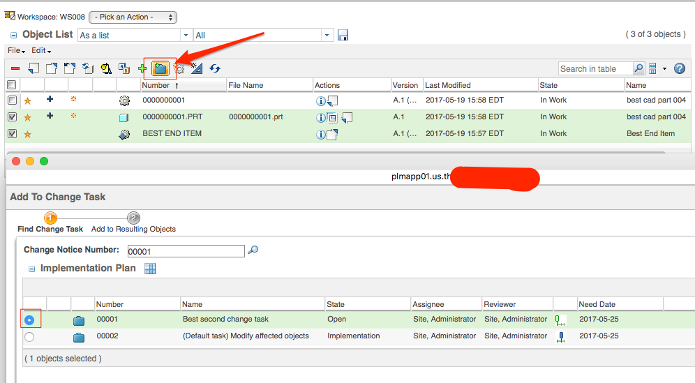

Hello everyone,
I hope you can help me.
I would like to know, how to export objects from the workspace to my resulting objects?
Because in fact, I have no other method than to manually search all my references.
Out according to the study processed the list can be very long and take a long time.
In hope to have a better solution.
Thanks in advance.

This feature was added in 11.0 M020.  If you are not on an earlier version it will not be available.

Which version of Windchill are you in? In Windchill 11, there is an add to change task action in Workspace

May 19, 2017 2:36 PM UTC
Hello Binesh Kumar,
I work with Windchill 11, can you explain me how I can do that?

May 19, 2017 8:07 PM UTC
This test server is on 11 M020 , I don't remember  whether it was introduced in M020
