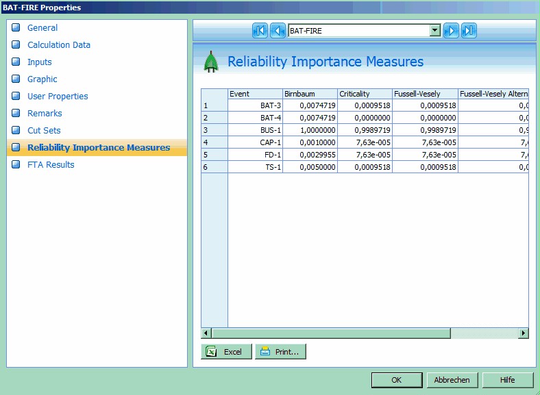

I am using Relex 2011 Fault Tree Analysis (Relex Team Edition M080) for reliability calculations.
I find anoying to not have the possibility to export (e.g. to excel file ) the reliability importance measures in Relex 2011.
Does anyone know how to export the reliability importance measures?
Thanks in advance for your help.

September 17, 2015
Hello Marcel,
see attached image. There is an "Excel" button at the bottom.
Thomas
