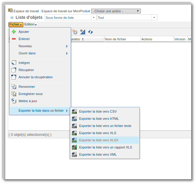

Ok it's the workspaces content.
But it already has the 'export to file' action ! ( sorry, picture below in French 🙂 )

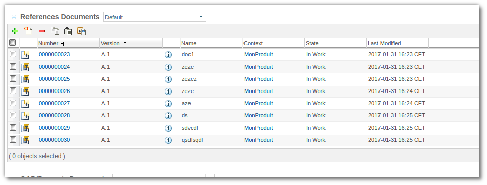

Ok, so there are 2 cases :
The easiest one, your table already has a menu, like the parts references documents

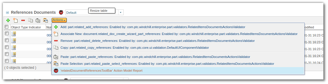

If you add &jcaDebug=1 in the page URL, ie : Windchill/app/#ptc1/tcomp/infoPage?oid=VR%3Awt.part.WTPart%3A149827&u8=1&jcaDebug=1
You can find the action model used by the table :
in my example relatedDocumentReferencesToolBar in the definition file: /config/actions/PartDocument-actionmodels.xml

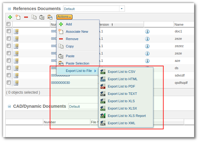

And you just need to add the actionModel in codebase/config/actions/custom-actionModels.xml
and insert the action folderbrowser_toolbar_exportlisttofile_submenu  like this.
  <model name="relatedDocumentReferencesToolBar">
      <action name="related_add_references"                    type="part" shortcut="true"/>        <!-- Add References Document -->
      <action name="related_doc_create_wizard_part_references" type="document" shortcut="true"/>    <!-- Create and associate a references document -->
      <action name="related_delete_references"                 type="part" shortcut="true"/>        <!-- Remove References Document -->
      <action name="related_copy_references"                   type="part" shortcut="true"/>        <!-- Copy to Clipboard -->
      <action name="separator"                                 type="separator" shortcut="true"/>   <!-- ===================================== -->
      <action name="related_paste_references"                  type="part" shortcut="true"/>        <!-- Paste References Document from Clipboard -->
      <action name="related_paste_select_references"           type="part" shortcut="true"/>      <!-- Paste Select References Document from Clipboard -->
        <submodel name="folderbrowser_toolbar_exportlisttofile_submenu"/>
   </model>
After reloading the actions, or a server restart , you can export to XL and even more 🙂 :

Which table is it ?
Feb 1, 2017 9:47 AM UTC
