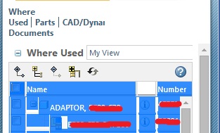

Hello folks,
Can anybody tell me how to export where used report in MS Excel format in windchill PDMlink?
I searched a lot for this option but couldn't find.
Kiran

As a work-around until they confirm whether it's added or not...you can highlight all the files in the table and copy it using Ctrl-C. Then paste it in Excel.
You can get the headers too. However, not from the top down. What I do is go to the bottom-right in the table and drag all the way THROUGH to the headers. Copy/paste to Excel.

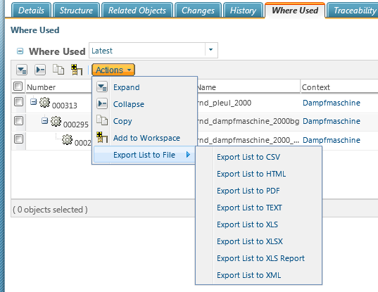

If you don't mind to customize your system, you can add the export commands to the toolbar:
You need to add something like this to your custom-actionModels.xml
<!--Test Export List Where Used-->
<model name="whereUsedTablePart">
<action name="explode" type="folder" shortcut="true" />
<action name="implode" type="folder" shortcut="true" />
<action name="whereused_copy" type="object" shortcut="true" />
<action name="WFADDTOWORKSPACE" type="folder" shortcut="true" />
<submodel name="folderbrowser_toolbar_exportlisttofile_submenu"/>
</model>

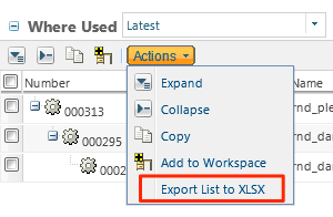

Or add only the export to xlsx to your toolbar
<action name="exportTableXLSX" type="object" />
<!--<submodel name="folderbrowser_toolbar_exportlisttofile_submenu"/>-->
</model>
But I agree with you. This table should be configurable and the common actions should be available!
