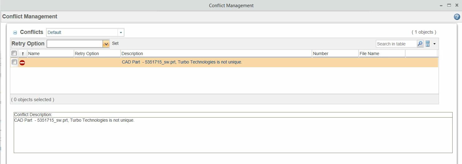

I have a scenario in my organisation. Someone has created a CAD document with a P/N 1234567.prt.
Now same part number needs to be used by other user and this new user is trying to upload the same 1234567.prt from his work-space.
It shows a conflict with following message,
1234567.prt, is not unique.
Generally, we receive this message when we have P/N with same name exists on common-space,
but when i searched this part number, I cannot see it.
This means that this P/N exists in uploaded state to some user's work-space.
I am not sure who that user is.  I s there a way at any level we can identify this user or search these parts?
