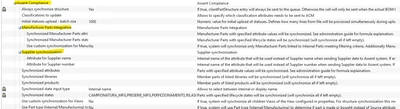

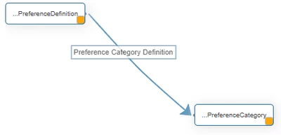

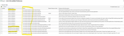

I believe you are seeing duplicate preferences because the two tables selected in the report are not linked to each other, and therefore the results are multiplied.
Try joining them in this way, and you should see only unique values.
Keep in mind that the Category Name column may have some preferences with sub-values that have a different category name.
See this example.
On the left are the preferences set in Windchill and on the right are the results of the report.
Marco
