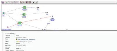

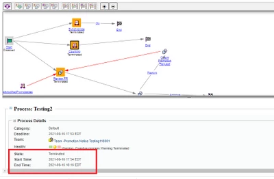

    I made a test workflow and terminated it from the OOTB Process Manager.
    Before Terminate
    After Terminate

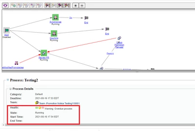

    I then wrote and ran some code in a Windchill shell to restart where it was when terminated but I could have just as easily started it up
    anywhere in the process.
    After Restart
    Note the Start Time is the same in all images.
    Where as this is suppose to correct an inadvertent termination I decided not to update the workflow's original Start Time. Although updating Start Time is doable.
    Note the End Time is updated in the images.
    Note that the Expression and Synch robots were also terminated and restarted.
