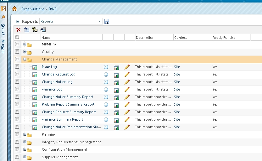

Windchill OOTB Cognos reports are available in Context > Reports. If it is a product, Product > Reports. When you have Cognos installed, the reports will run on Cognos in the backend and display the results. If you don't have Cognos, then basic HTML page will get displayed.
If you want to create custom report, Report Management Utility is place where you create reports - http://www.ptc.com/cs/help/windchill_hc/wc102_hc/index.jspx?id=QBReportMgrAbout&action=show . There are a lot of existing reports shared by the user community   You can download and import the reports to your system.
If you want to create reports and run it through Cognos from Windchill. Follow - https://support.ptc.com/appserver/cs/view/solution.jsp?n=CS148905

As you mentioned, I've created a sample report through  Windchill site -> Utilities->Report Management and exported it as QML on my desktop.
Opened Cognos through URL and launched report studio but there I'm unable to find any import option to import already exported QML.
Please  suggest me for this.

As you mention it is 10.2 M030. you have to update the  WBR fix patch. the run the following commands to load the reports.
run into shell
1. windchill com.ptc.windchill.enterprise.report.ReportHelper modelupdate
2.  windchill com.ptc.windchill.cognos.CognosProxy loadreports <WindchillHome>\loadFiles\cognosReports\pdml
3.  windchill com.ptc.windchill.cognos.CognosProxy loadreports <WindchillHome>\loadFiles\cognosReports\wnc
4. ant -f <Windchillhome>/installer/wnc/wbr_actions.xml
5. Clear the windchill and browser cache --> Restart the windchill

Hi All,
I'm now able to generate reports in Cognos.
I've run above mentioned activities in Windchill and did some changes in site.xconf and finally achieved it.
