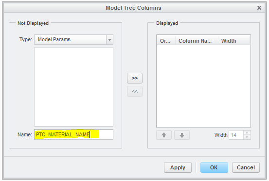

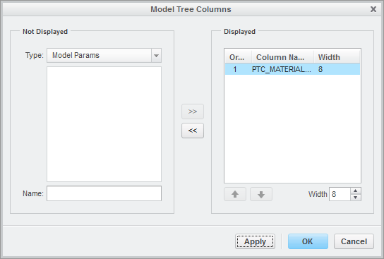

Apr 22, 2016 8:59 PM UTC
For whatever reason it's not shown in the model parameters list, but you can still manually type it in.

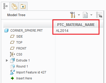

Apr 22, 2016 9:01 PM UTC
If you add a bunch of materials to the model, then you get this nice little dropdown to pick from.
