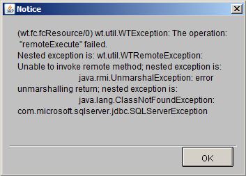

Feb 17, 2016 12:22 PM UTC
Hello Binesh
I exchanged the server name and tried to execute, but unfortunatly it did not work. Take a look at the message:
Thank you in any case.
2-Explorer
Feb 17, 2016 1:06 PM UTC
Hello Daniel,
Could you try recreating a new query from query builder? The only table in From is Part and the the select should be as I have in my screenshot
Thank you
