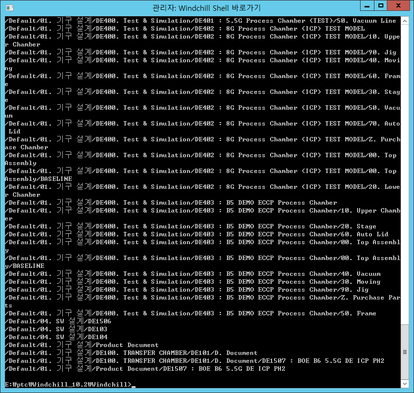

How to get a text list of folder names in Product Container
Step One
Copy the codes below:

Step Two
Execute MyWindchillUtility on Windchill Shell:  windchill ext.MyWindchillUtility
Jan 23, 2017 9:46 PM UTC
What's the definition of DGUtil? Is it a custom class where you are manually retrieving the information?
