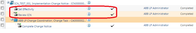

Can anyone tell me how to get the tasks of a Changenotice/Change request/Change Task in java code.
for eg: "Complete ChangeNotice". I need to know the status of this task in the java code.
