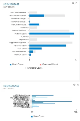

    If Performance Advisor is enabled for Windchill, weekly or monthly the system collects this information and sends it to PTC, which then posts it on the customer's dashboard.
    How is this information extracted and how can the user ID, written in the xml files of data sent to PTC, be linked to an individual (with first and last name) to verify who is accessing, what type of license they are using, and when they are doing so?

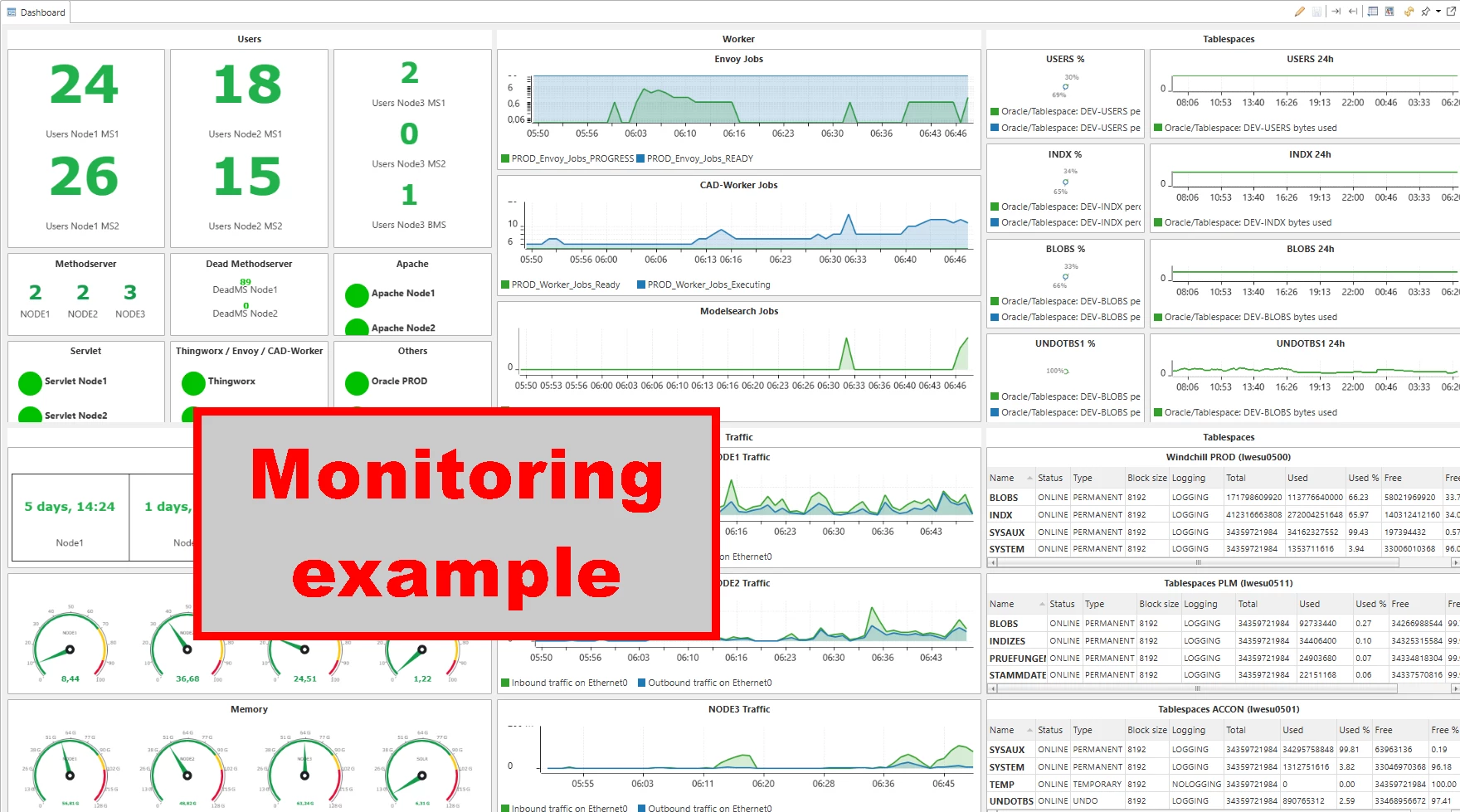

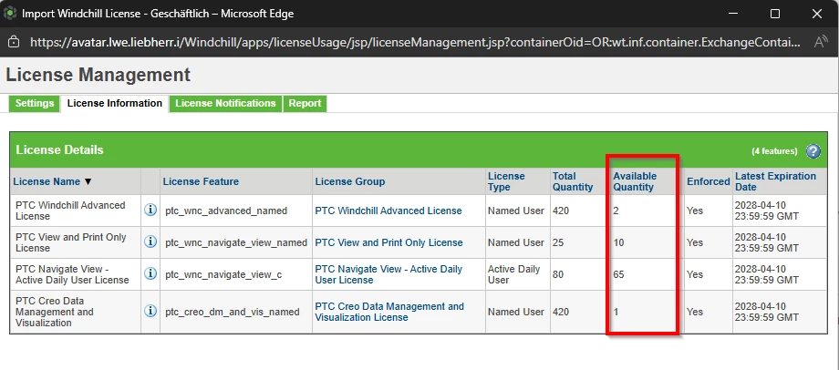

    Nov 5, 2025 6:14 AM UTC
    SQL statements?
    The license topic is a complex thing.
    Our Windchill env is one of the larger systems. Sometimes we run into license problems with Navigate.
    We are monitoring the Windchill with several tools like MBeans, SQL and so on.
    The license report tool is not the "live monitoring" solution. Does anybody solved something like that?
    Live view of used licenses?
    See attached screenshots.
