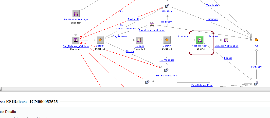

I have a requirement, where my custom java code takes an input of ChaneNotice number, and returns where it is stuck in its associated workflows.
I am able to capture in the code if it is stuck in any of the tasks ex:"Complete change Notice" or "Review ICN" and etc. But due to some issues, my CN got stuck in ESI workflow in "Post_release" Sync Robo. So i need to capture this in my java code and return to UI.
Using "WorkItem" API i am able to capture tasks of CN. In the same way I need an API which will represent this "Sync Robo" components of workflow.

You can query sync robots in wfprocess using below API's
       WfProcess process=null;
       QuerySpec qs1 = new QuerySpec(WfSynchRobot.class);
        qs1.setAdvancedQueryEnabled(true);
        qs1.appendWhere(new SearchCondition(WfSynchRobot.class,
                WfActivity.PARENT_PROCESS_REF + "." + ObjectReference.KEY,
                SearchCondition.EQUAL, PersistenceHelper.getObjectIdentifier((Persistable)  process).getId()));
        QueryResult syncRobots = PersistenceServerHelper.manager.query(qs1);
