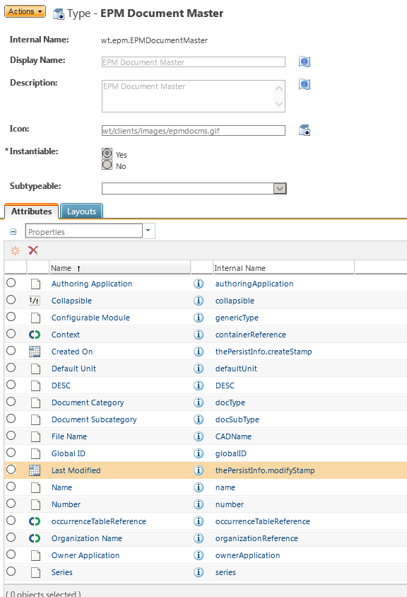

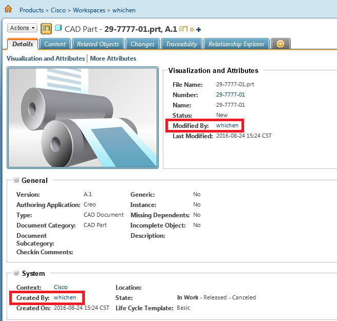

I want to get the attribute of (Modified by and Created by) in CAD part, but in EPMDocumentMaster, this attribute is not exist, how can I get them by API?

You can get EPMDocument and from EPMDocument you can get creator and modifier as follows-
sample code is as follows-
EPMDocument epmdoc = ext.Search.searchCADDocByName("fixtureblock.prt");
System.out.println(epmdoc.getCreatorName());
  System.out.println(epmdoc.getModifierName());

But your mentioned method getCreatorName() and getModifierName() are belonged to EMPDocment, my search result is EMPDocumentMaster, it don't include these methods you mentioned.
How can I get the "Created by" and "Modified by" in EMPDocumentMaster? Thanks for your help.

You can get latest EPMdocument from EPMDocumentMaster and then get the necessary information.
Sample code to get the last version of EPMDocument is as follows-
