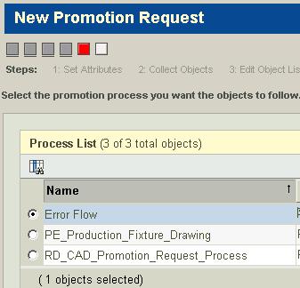

how to get workflow process name when create promotion request
such as following picture,
how to get selected workflow name "Error Flow", "PE_Production..." or "RD_CAD_Promotion..."
by API.
thanks in advance.

where are you planning to use API,
There are two forms which can be used.
below can be used in Wizard.
PromotionRequestHelper.getWorkflowTemplate(FormDataHolder paramFormDataHolder)
second is
PromotionRequestHelper.getWorkflowTemplate(WTContainerRef, State, String)
Here String can be Null  or put process name
after that you can used  getName(); method.
Hope this will help you.
