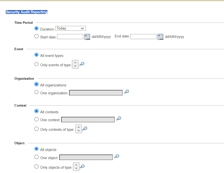

This article discusses how to give access for users to run reports:
https://www.ptc.com/en/support/article/CS292726?source=search

2/It's the security audit reports page, not the Report Builder I was referring to (see attached). I want to provide another group of users access to be able to generate their own security audit reports; for example, running a report of who accessed a particular document.
