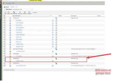

Jan 18, 2023 8:39 PM UTC
Please find attached a screenshot. It is product --> Teams
