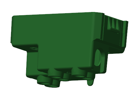

Hi Gregory,
thanks to your suggestions (do you remember hidden preference on 10.1?), last year we started using multi owner link.
It works great to build structures but we are struggling with viewables and our consultants have scaled a call to R&D to have a solution.
They also talked to some Product manager last year in Nashville for the same reason.
See attached pictures (first is from details tab and second from structure/visualization).
They are from same object but, as you can see, in the second some components are missing.
In other cases some components are showed in their default coordinate system instead of the position they have in assembly.
Have you noticed same behavior?
