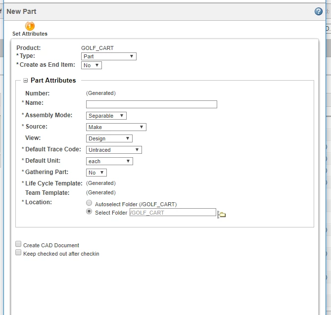

how to hide an attribute when it is not end item ?
Hello guys ,
I want to hide Description attibute if it is not end item .it need to display only for end items .please suggest some approaches to achive it .
Thanks !

Use Cascading Attributes, the thread can be closed!
Mar 29, 2018 6:26 AM UTC

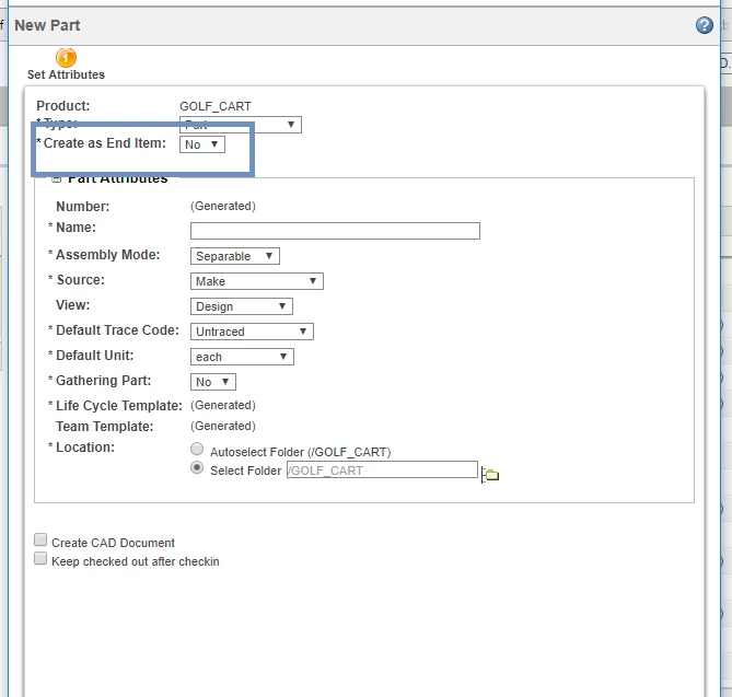

Since an End Item is not a subtype you won't be able to remove the attribute without customization. I would recommend a data utility which gets the dropdown menu of the end item and dependent on that, it will show the text box or not.

I have done something similar in the past. Do you need to hide attribute on Create Wizard?

when you flip the end item flag the attribute panel is getting refreshed.so apply a validator to hide the attributes.
