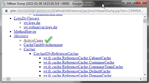

How to identify the server manager a web client is connected to?
Curiosity question for today, is there a simple way to identify the method server a user is connected to? I haven't had a hung MS in a bit, but its always tricky to diagnose who's still connecting to a hung MS before its shutdown.
We run 4 MS on the production server and it would be nice to display the MS ID next to the username in the WC header.

I would use
String methodServerName = ManagementFactory.getRuntimeMXBean().getName();
This method return PID@SERVERNAME  example: 6156@wch12020
you can check PTC article CS146093  where is used a jsp page to retrieve that info.
also you can add it to a "alert message"(begin_custom.jspf) which is the best way to present that information to a user. it is described in the article CS146093  .

The Server Status page in Site, Utilities
Clicking on the method server in question will produce an MBeans dump which includes a list of the active users under Monitors, Active users.
I'm not sure whether the MBeans dumb will work when the Method Sever is hanging, if you can access the server then maybe view the MBean in your Java Monitoring and Management Console, like windchill wt.util.jmx.SMJconsole
The server status page also shows a star next to host, server manager and method server you are connected to at the time.

HelesicPetr
Jan 6, 2022 2:42 PM UTC
good point with the star on the status page 😄
That's true, but only site admin users have access to the status page.
If you need identify a normal user it is more complicated.
