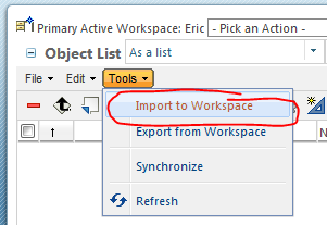

Dec 5, 2014 1:23 PM UTC
Just to clarify something here, you can bulk import to Windchill but doing so uses a running Creo session. You have to access the workspace from the Creo embedded browser. You don't have to physically open every file in Creo and then manually save it to a workspace, but you do have to have a running session of Creo for the workspace to use. Make sense?

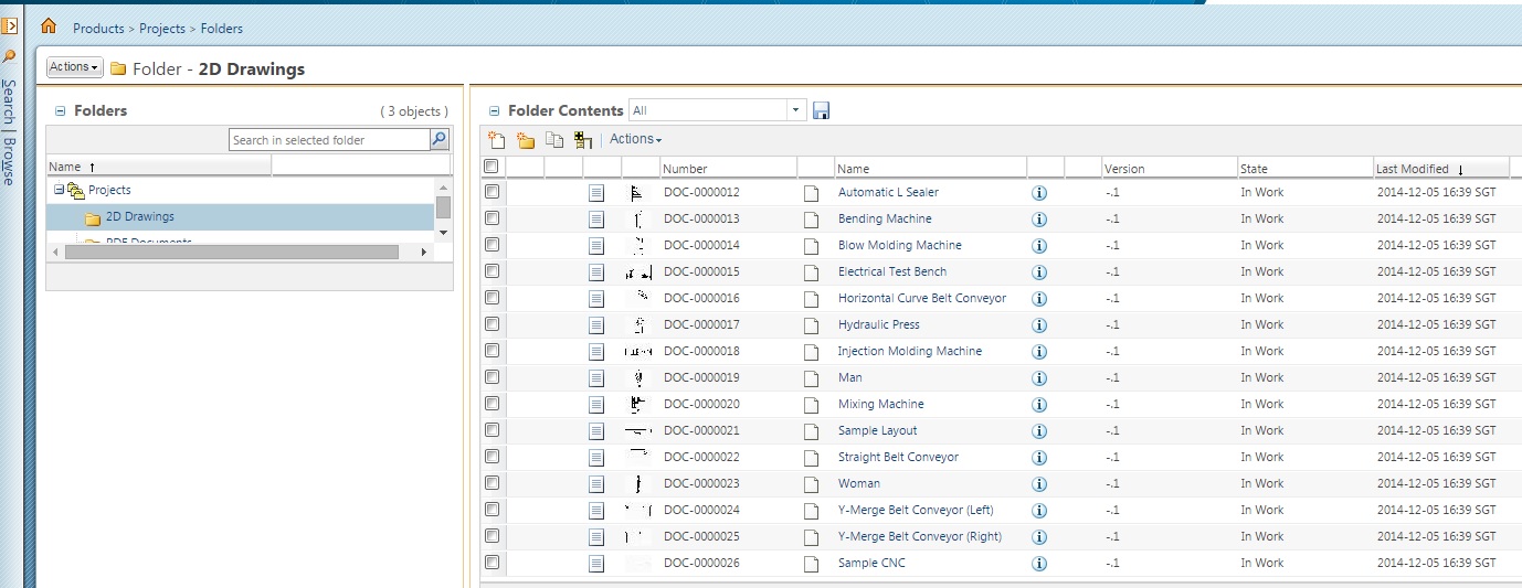

Dec 8, 2014 3:03 AM UTC
Hi all,
So if I upload it directly to windchill it will be treat as a document? I upload .dwg drawing directly to windchill and I get this. it considered it as a document file.
TomU
Dec 8, 2014 3:10 AM UTC
Correct. The only way to create a CAD document (EPMDocument) is with a workgroup manager for that specific CAD type. Creo files can only be created and loaded into the system from Creo, Solidworks files from solidworks, etc.
I don't believe there is a workgroup manager for DWG. Instead it is treated as any other export data (PDF, IGES, DXF, etc.) and will be stored as a standard document.
