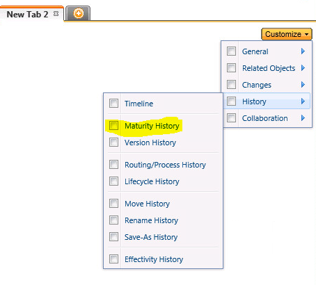

Sep 8, 2016 3:45 PM UTC
You are correct that the "Iteration History" will only show as you explained in your "Actual Scenario".  However, have you looked at the "Maturity History" of the object?  This should show the changes in lifecycle states as well.

Sep 8, 2016 4:17 PM UTC
The maturity history does not show in the OOTB "History" tab (colored blue), but if you add a custom tab (colored gray) you can select it in the Customize drop-down, under the "History" section:
