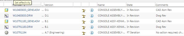

We had some custom programming done and I assume with PTC's assistance.  Prior to the custom programming CAD Support would manually manipulate the WTPart revision.  We use FTIteration (Family Table Iteration) when we do not want the WTParts to advance revision.  For instance I am adding more instances to a Family Table.  There is nothing changing to the existing Family Table instances.  We will add the WTParts to Affected Objects and choose to run an FTIteration on the WTParts.  This will add the WTParts to Resulting Objects of the Change Notice, but keep the existing revisions.
Note the State of FT Iteration which does not advance the WTP revision.  I could ask our CAD Support how this was accomplished if necessary.
