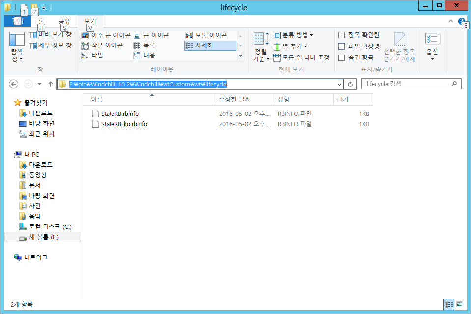

Make a directory folders for life cycle state.
I made a directory (\wtCustom\wt\lifecycle). Then put the folders under the Windchill home directory (%WT_HOME%).
Here is the Windchill Custom Life Cycle directory: %WT_HOME%\wtCustom\wt\lifecycle\
2. StateRB.rbinfo
Make a StateRB.rbinfo (File Extension: rbinfo) file for English language pack
Example:  E:\ptc\Windchill_10.2\Windchill\wtCustom\wt\lifecycle\StateRB.rbInfo

Well, I installed Korean language pack on Windchill. Therefore, I made a StateRB_ko.rbInfo file for Korean language pack

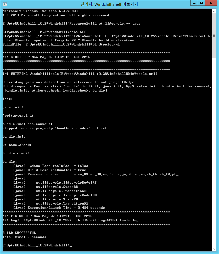

3. Resource Build
Execute the following command on Windchill Shell: ResourceBuild wt.lifecycle.** true

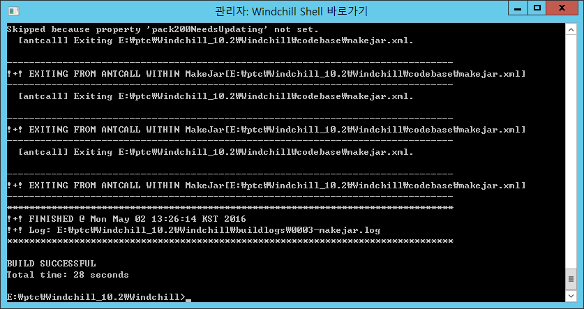

4. Ant Build
Execute the following command on Windchill Shell: ant -f codebase\makejar.xml

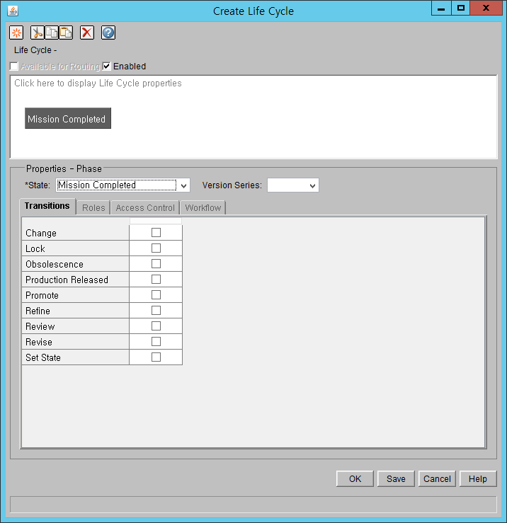

After completing build, check whether a new state is created correctly.  Yay! Mission is completed.
