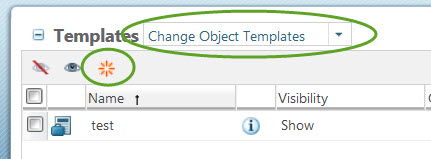

How to make "template" field as required in New Change Notice Window.
How to make "Template" field as required  in New Change Notice Window.
Sep 9, 2015 5:35 PM UTC
Hi Bhagirath,
You can extend com/ptc/windchill/enterprise/change2/dataUtilities/ChangeNoticeTypePickerDataUtility.java and override the getDataValue method. Just check if the object returned is of type com.ptc.core.components.rendering.guicomponents.ComboBox and if so set it as required using setRequired method.
Out of the box, this class is registered in  codebase/com/ptc/windchill/enterprise/change2/ChangeManagement-components.dataUtilities.properties.xconf
Let me know if this helps.
Bhushan

Sep 9, 2015 4:58 PM UTC
This action is available only to Administrators.  You start in the Templates for a Product/Library/Org/Site.

Sep 9, 2015 6:28 PM UTC
sorry for my simplistic answer - I misread the question
