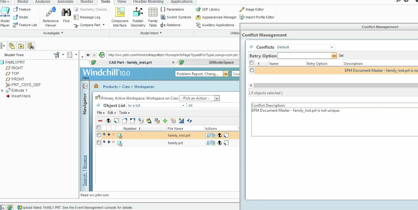

How to manage family table in windchill
How to manage family table in windchill ?
Part_number & part_name remains same for generic and instacnce . Only file name is differnt .
When uploading it is showing error"cad part not unique"
Pls find attachment
Dec 17, 2014 5:47 PM UTC
You need to give them another name when they are created. Someone else ha already created a file names family_inst.prt in your system.
Using 'generic' or default names is asking for troubles down the road.
Dec 18, 2014 2:03 AM UTC
Hi
File name is ok. What abot Part_number & part_name parameter ?
