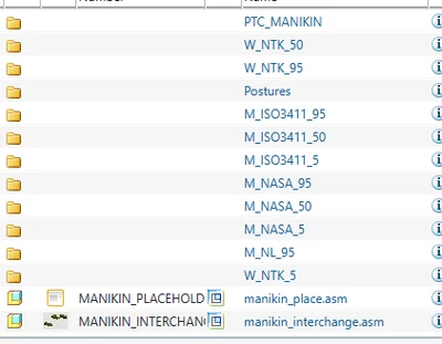

3 What is the correct way to save a Manikin in the Windchill library and retrieve it when a user accesses the Manikin module?

Consider upgrading your Windchill version as its off support. For the manikin, we created matching folders and structure in Windchill the same as you would on a local drive:
Ensure users are read only to this area so it does not get modified. In your config.pro, you can call out Windchill folders like this:
ptc_manikin_library_path wtpub://PDMLink/Libraries/General Parts Library/Manikin
Note that the hostname alias needs to be consistent for all users so best to align that across the board. Same can be done for other libraries.
