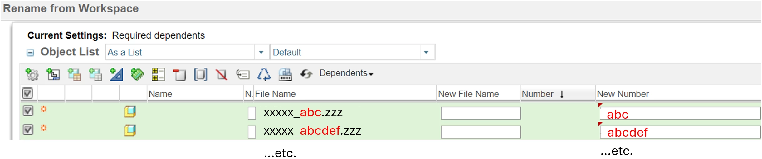

How to mass populate rename fields in Windchill
I need to populate the New Number field for thousands of parts/assemblies in Windchill. See attached example: The New Number simply needs to be the string between the first underscore and the file extension of the File Name field (red font). I hope I don’t have to individually copy paste each of these.

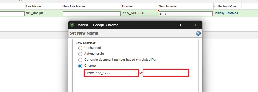

Hi ​@garettpatria
If your xxxx string has a same size, then you can use the ? character in the mass rename function.
The one ? is equal to a character.
Example ???_ABC.??? to *
then the result is ABC
PS: you can not use the * char because the system always chose the first one to keep it as a result :D

I am not sure something that can be done in that UI given the sheer volume you are dealing with. The tool does have a way to do some simple patterns. I would recommend using a command line rename script to handle this. I have a few I wrote for this very case. Feed it a CSV file and let it chunk away at it. Knowledge base has this this article:
Which API can be used to change or rename the identity of several Objects in Windchill PDMLink
