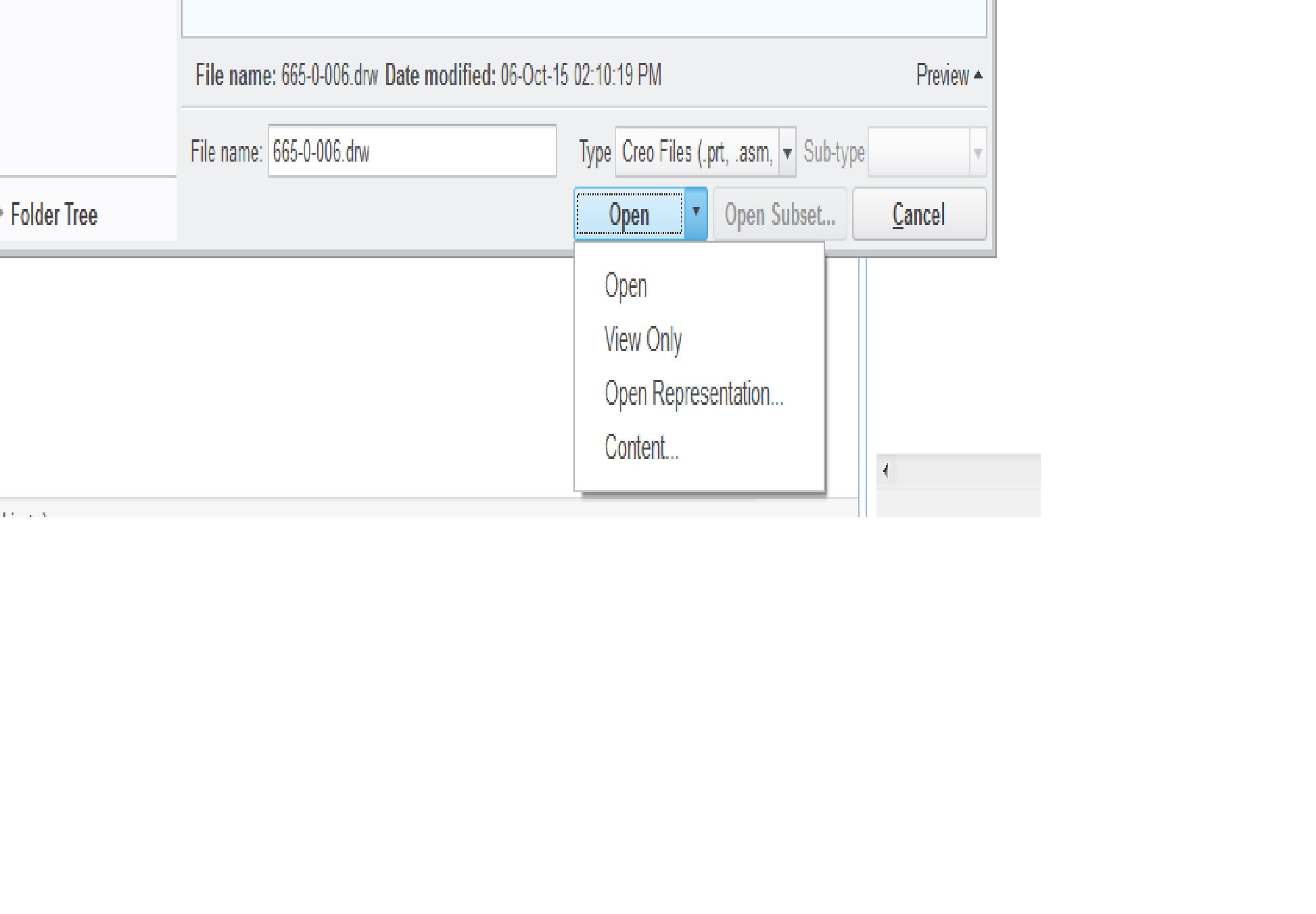

Oct 7, 2015 1:55 PM UTC
you can not open specific rep by defaut, even you modify the option, but you can open the one as follow
